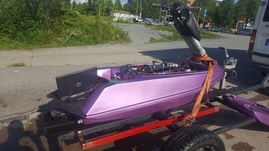

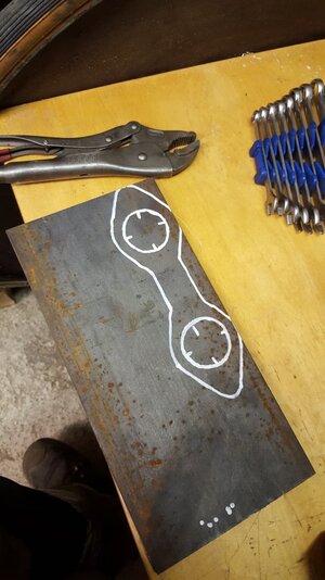

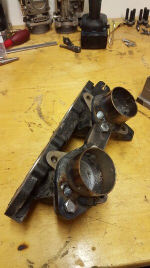

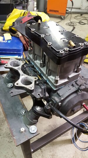

Hello, This is my project to build MAXX HULL with injected motor.
a picture is worth a thousand words...

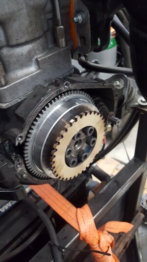

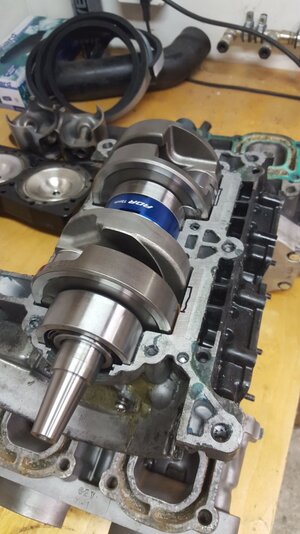

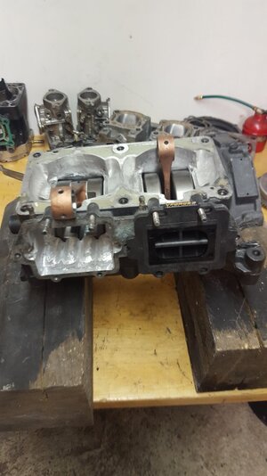

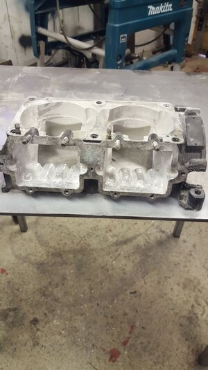

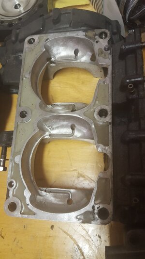

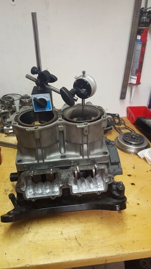

Here we start crankcase and +5mm to put case. Its need little machining.

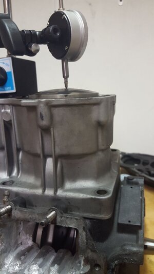

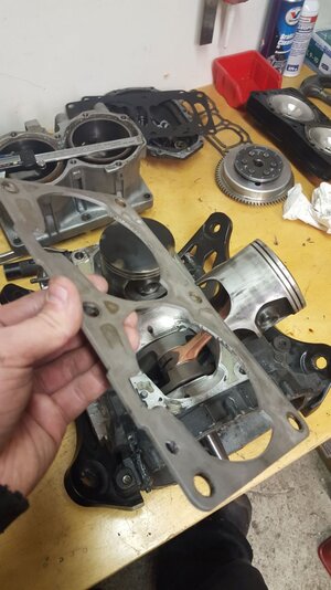

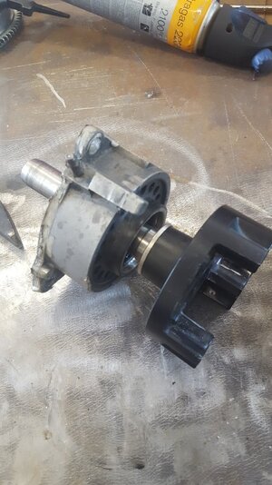

After accurate measurements spacer came to the right size.

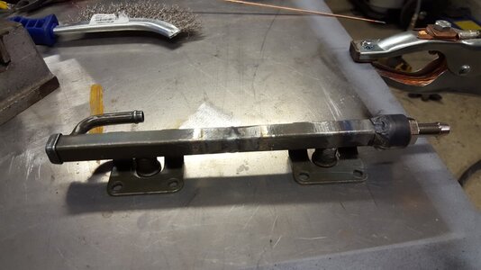

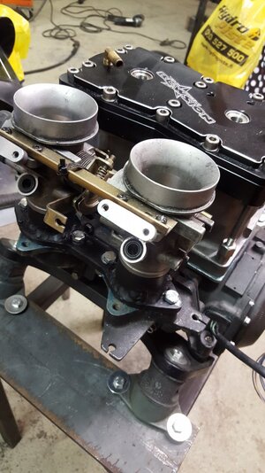

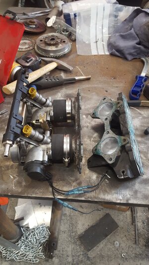

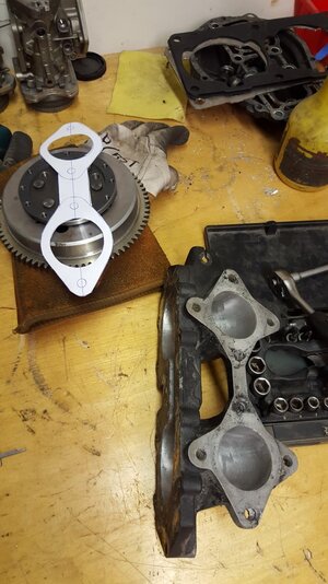

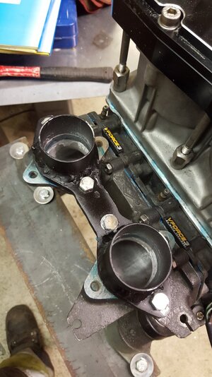

Carburators was modified to replace the throttle bodies.

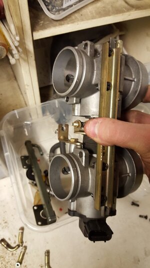

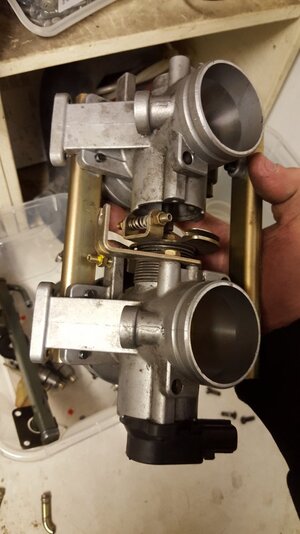

Throttle body is Arctic Cat snowmobile. Still it has to modify the distance.

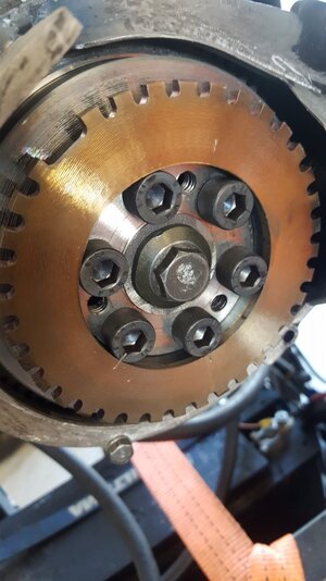

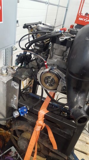

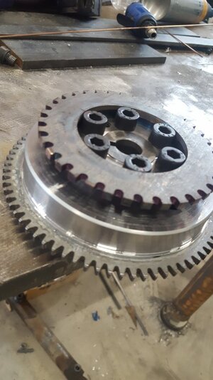

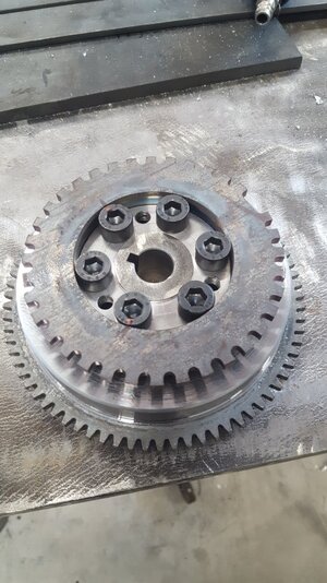

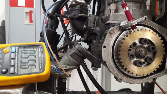

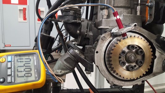

This use only one hall-sensor,after a number of companies that ended up. its work very well.

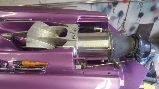

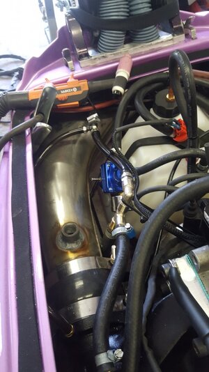

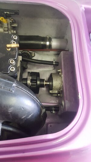

I try pro-tec pipe but its nonono. Too massive too big. Midsaft have to shorten.

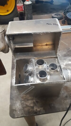

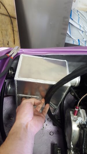

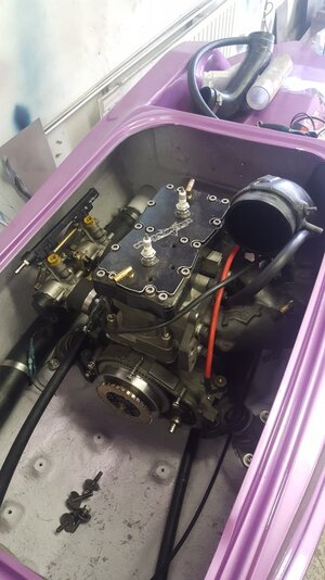

V3 waterbox is too big...so i modified. i put v3 pipe its better fitment.

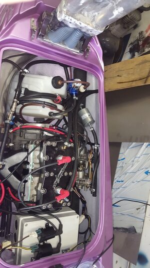

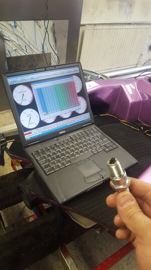

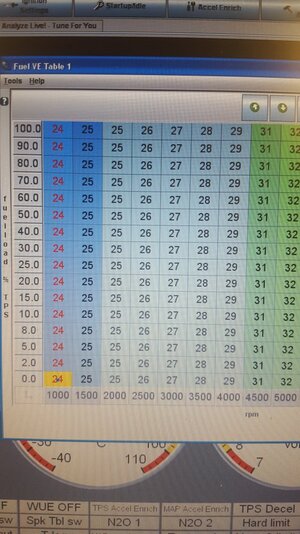

Wideband lamda to obtain a 13 to 14 AFR it's pretty good. Throttle response is really good. Ecu is Atecu and tuned only laptop.

cmj
Indiana
Are you using a MAF for tuning or is it all RPM/TPS?
Also.. I assume you are doing Total Loss so you are not trying to overcome the draw of a fuel pump. Is this correct? What type of run-time do you expect?
Very cool project!
Finland

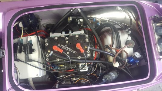

6/14 prop.maxx 155pump. Now is tps (use alphaN) fuel map and ignition. This is 2battery system, one for starter and one to ecu and fuelpump. Ecu battery flywheel charging.
I dont no time yet...
Now i have to made airbox to throttle body. Now bodys is too low and water tease.

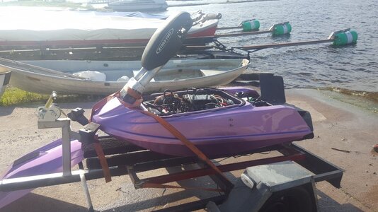

Today i drive 8litres and works very good. But impeller is too low pitch i think...it feels like drive a car 3th gear all time.
6/14 impros. This set need more torque i think 1200 is better....

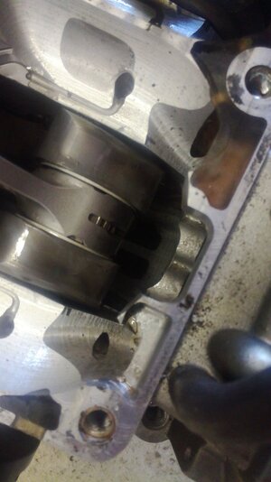

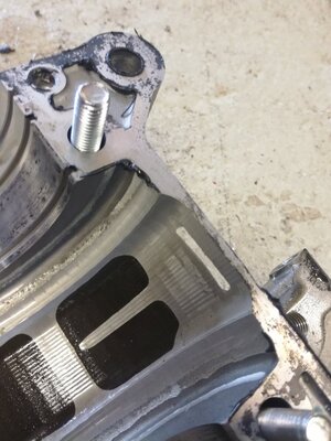

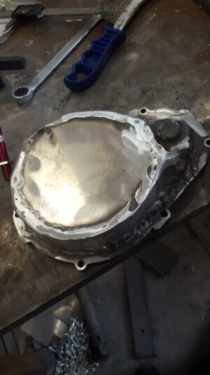

Damn....engine eat gas and epoxy. I dont now is this jb or not.
And If use mill to case dont take too much...i drive 1h about when i hox what a licorice its Lean...
Picture is same motor and over then
1000cc...
