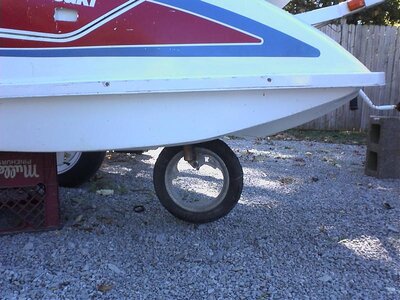

WOW that thing is great. I only got to push it and ride it like a scooter for now... but it is so easy to ride and pretty cool looking to match. I had some pictures taken but will have to have them emailed to me so it might be a few days.
The down fall... the wheels above on the scooter will not hold up to the weight or the turning force of the ski. And the stock ball socket for the turning has a ton of slop. I am ordering heimjoints to make it more responsive.
I rode it about 1/2 a block and the front wheel broke. It is just the perfect height for me to push it with the pole down pick the pole up and jump on. Here is a picture of the broken front wheel...
I am convinced that it will work so now I can invest some money into the project. I am going to stay with 12 inch or under wheels I just need them STRONG. Maybe a moped instead of a scooter.
Any suggestions??
