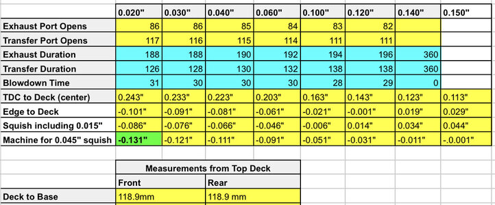

The issue with that is with the yamaha engine is that it already has to little transfer port flow for the size of the engine. if you big bore it you are moving into the transfer flow even more with a big bore sleeve. This is just one of the reasons that the stroke is a better option on yamaha based engine than a big bore. So in theory more capacity is more power in reality its not quite right with the yamaha based engine if you do it incorrectly.
Im not saying what you wrote is right its just a cut and paste from a txt book and is really just a generic statement
this is a much bigger deal than most realize,its so easy to do it just the slightest bit incorrectly and lose a ton of power potential. The more motors I personally experience the more I favor strokers and big flow. Ive been doing some experimenting to that point. The motor scotti was referring to above is a perfect example,8 mill lamey with tiny pistons,sub 800cc motor.Hit hard, pulled great all the way to top end,made way more top end power than any of us would ever need for non racing purpose.For freeride/rec ski we have so much simpler setup to configure,We dont have to worry about sustained top end,mph gains.Just has to hit hard and pull good on midrange. huge advantage in designing and tuning the setup. Its all about flow....not CC
