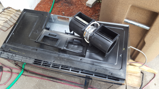

So you don't lose your cool after you just blew up your ski heres a quick diy on your new favorite shop fan.
These fans are pretty quiet and move tons of air so before you toss that old nuker, snatch that fan from it! And dont forget the capacitor!

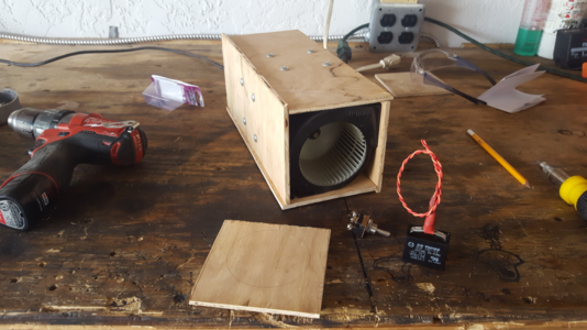

$5 for the on-off-on switch
There's almost always a sticker with the wiring diagram located on the fan.
Put little screws through the wood into the plastic but make sure to use plenty liquid nails when final assembly of the wood.

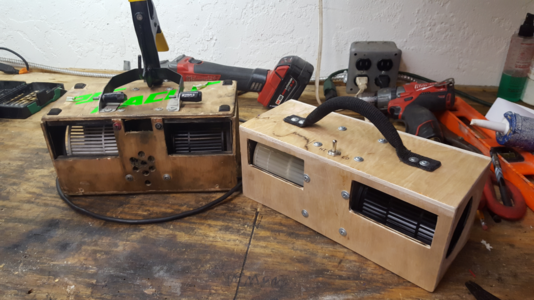

My old nuke fan has been running almost everyday for the last 2 years and shes still as quiet as the day it was built.
