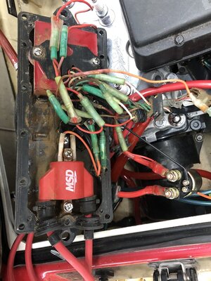

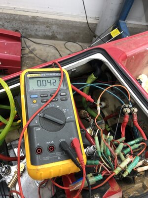

Hi guys I have a weird one for the electrical experts here haha.
I’m finishing up a 61x swap on my square nose and swapping over all the electrical. When I go to test crank the engine I get no crank. There is 12v at the orange wire for the starter solenoid when hitting the start button with wire unplugged from the solenoid. Voltage goes away when orange wire is plugged into the solenoid and hitting the start button. New solenoid and new start switch already installed. Tested grounds are good. I swapped cdi’s no change. If I jump power from battery post to orange wire the engine cranks. So I’m having a hard time finding why the voltage disappears for the solenoid when everything is plugged in.
