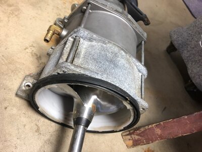

Started stripping her out tonight.Gets new paint and turfLots of small issues to take care of,but the old freak has done well for 4 years.l haven't much to it in that time.
Took the pump out,it's going to be rebuilt.Looks like the prop needs some love too.And getting rid of the wsm wear ring.Look at the difference between it and the Solas stator.As you can see the oem pump shoe is missing a piece,(wondering if that's where the prop got roughed up) that will get an aluminum one.The midshaft is getting a rebuild too.Just a little bit of rust on it.
Got the pole off and pulled the steering and throttle cables out.l still need to get the hardware off around the pole bracket area and glass up the two extra large holes.The pole surround needs some love too.Has some spider web cracks in it.l also want to redo the cut areas.Make those cleaner.The pole will get sanded down and painted.
I got all the strap hooks out of the engine bay.Just need to get the engine out now.
The only thing l can't decide on is molding in the tubbies or not.Probaby don't have enough time to do them right cause in a month it will be ride time.Just going to smooth them out,paint and reinstall.
