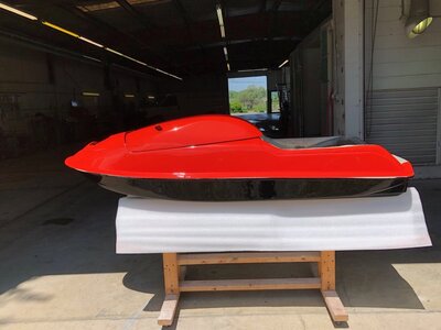

She's painted! In the pics ( @Jr. ) it looks red,but it's a dodge charger SRT color.Orange with gold pearl on the top and emron (you read right) black.We found an unopened can in the shop,That stuff is hard,so should wear well.Tops of the gunwale where the turf stops at the lip,needs some more sanding to even it out.But she's ready for assembly.l just lack a few things like fuel line and water lines.image.jpeg

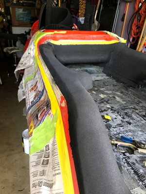

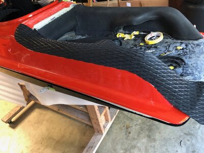

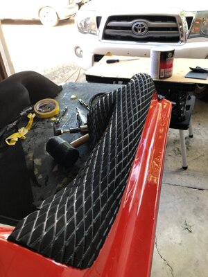

One of my concerns was when l changed the gunwales was how the finished product was gonna look.What l though was "will it look like it was made this way?" Or would it look like a "chopped up,WTF was he thinking junk" that failed in the end.But so far, I'm satisfied with the outcome.
Started with 3/8" padding on the side and dash,then turf over the sides.Today I'll work on the dash and footholds.Already have a rough template for the tray turf cut out.But that comes last.l also want to clarify that when you are doing padding and turf,do the sides and dash first.Then do the tray bottom.Seen several threads lately that others have done with the reverse of this! That said,what ever mistakes you make will be covered by the thick tray padding and turf.Pretty simple huh....Don't make it hard on yourselves

One of those SF turf jobs that turn into a larger project..
Got the sides,front foothold done,and padded the underside of the side holds.Gonna have to wait on finishing turfing the dash until l put the ebox in.But those pieces are cut and ready to glue.Tomorrow I'll finish the footholds and do the tray.All that's left is the rails.Those pieces are also cut and hull sanded.
