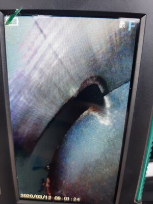

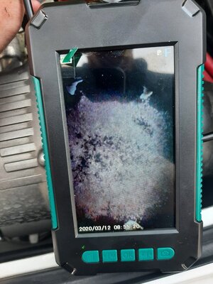

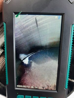

Checked with the endoscope, cant really see scratches or something on the cil. walls. The top of the piston is overall black with some chips missing around the ports.

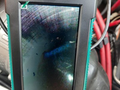

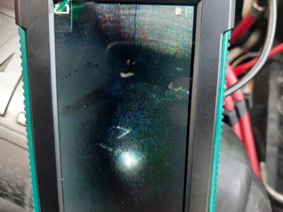

Checked compression later in the evening and still same results. Also checked inside the engine with the camera and i noticed something strange. The last time i checked, both pistons where almost completely black with chips missing around the ports, but now the rear cilinder was almost clean, with some kind of black spots at the center of the piston. Front piston was still black.
I will try to take a picture.

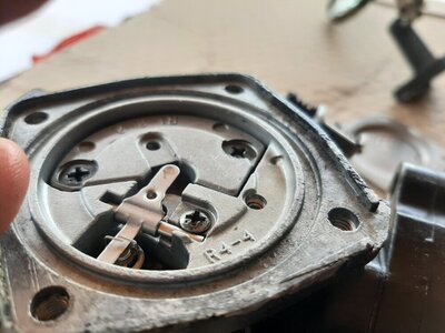

Im rebuilding the carbs right now.
Assembling then now. Look at the space between the needle and the thingy that lifts the needle up. Is that ok?
Don't suspect the cylinder is running lean. Know it is or don't mess with it. The most common way to know this is by doing plug checks. There are lots of posts here on the X about the right way to test this. You can also be sure by checking piston wash, something I haven't ever messed with, but piston wash is what you are alluding too with the differences in the carbon build up on your two pistons. Look up and read some threads using the key words plug tests and piston wash. I have found it easiest to search using googing and x-h2o.com "piston wash" rather than the forums search feature, but these days the search is working a lot better than it used to.
It's unlikely you are having seizures. You'd see scoring on the cylinder walls and lost compression or heat damage on the exhaust side of the piston. Not to say it's impossible, but it is unlikely.
It's very unlikely your problem and yes it looks fine. Only replace carb parts with genuine mikuni parts, (almost) never should you bend that arm as it has to work with the diaphragm, there are some good videos on youtube about it. Familiarize yourself with popoff testing and leak testing. Both are applicable to any ski you will own, regardless of how it is tuned, because those two tests are simply to ensure the carb parts are functioning correctly before you waste time trying to tune out a leak.

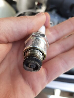

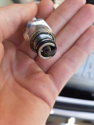

I attached some photos of the plugs (taken end of previous season, september 2020) and a couple of photos of the cilinders and piston via my endoscope. Hope you can see everything on there :D Note that the color of the rear cylinderis very different then the front cilinder. At this point i dont know which color it should be anymore. Also the chips at the ports in cylinder 1 are color brown. Piston number 1 is almost completely black.
