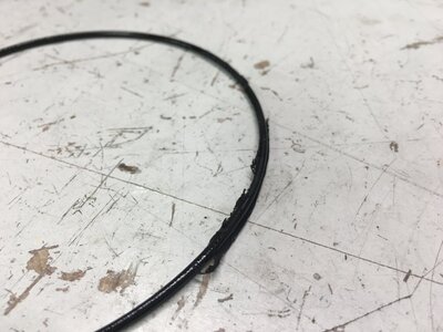

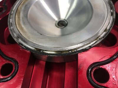

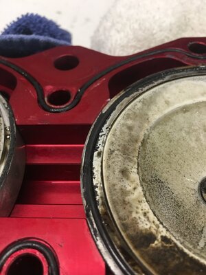

Update! I pulled the head off and not looking too hot. Looks like both orings some how blew. Both are fraying and rubber stuck on the domes. Both were still seated in the groove!

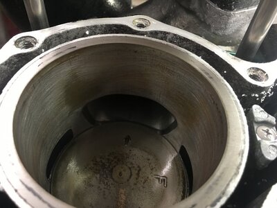

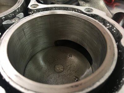

-Some minor rust on the cylinders.
-Both cylinders have some scratching, doesn't look too bad, barely can catch a finder nail on them.
-the white stuff in the water jackets literally dissolves when I pick it out and rub it.. not sure what that is! Thought it was packing peanuts at first haha
This motor (jet maniac top end) has about a hour if that of run time. Should I just slap new head orings back in and run it again?

There looks to be no damage so I would install new o rings and run it.
Question though, did you install the O rings dry or did you use a little grease?
I used grease and was very careful to make sure they stayed put when dropping the head on the cylinder. When I pulled the head, both orings were still seated in the groove.
