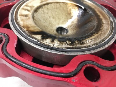

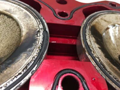

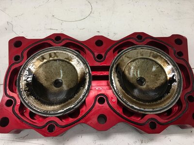

You may want to have somebody surface your head just to be safe. Unless you have a super flat surface and some ultra fine wet sand paper. I'd still suggest flushing the motor and pipe to get the possible debris out.
Replaced the o rings and did the same thing. Blew in the same spot! Any ideas??
