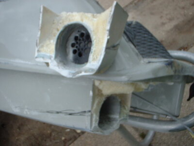

I want to shorten the tail last year but instead went conservative route.
removed 3 1/2 in. off the tail:

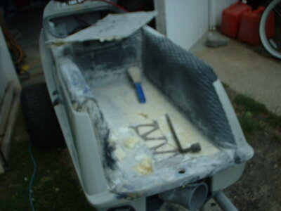

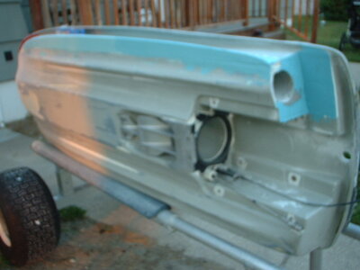

Tubbies are good so more would be better???? That's what I'm going with.
Tore the glass off a surfboard & used the foam to extend the tubbies & reshape the enitre rail.
