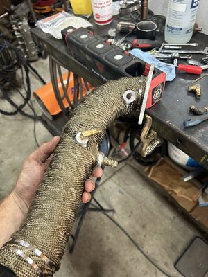

Added a 3rd cooling line to the exhaust and heat wrapped it .
Added a 3rd 1/2” line off the pump . Now have 2 1/2” feeding the engine and one just for the intercooler .

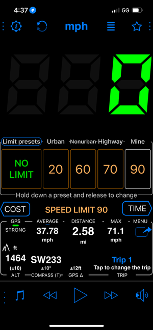

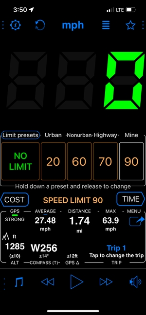

Got it on the water for a test ride . Water conditions not good with 30-40mph winds . Stock prop and intake grate .
64mph with the stock 12/17 sxr prop
I will have a 17/27 prop tomorrow to try . Hoping 10 pitch jump on the trailing edge gets me another 10mph
