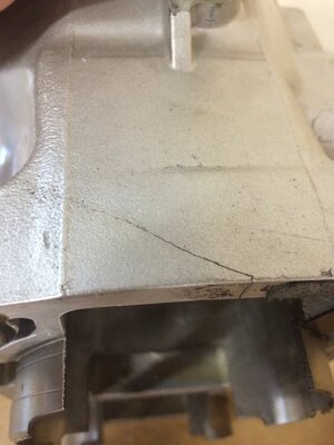

Yes cast aluminum can be welded but yours is cracked on a gasket surface to so it will have to be machined flat after welding. That may require the sleeves needing to be removedMine just cracked thru to the base. are you able to weld the cast aluminum?
