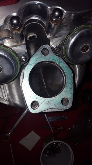

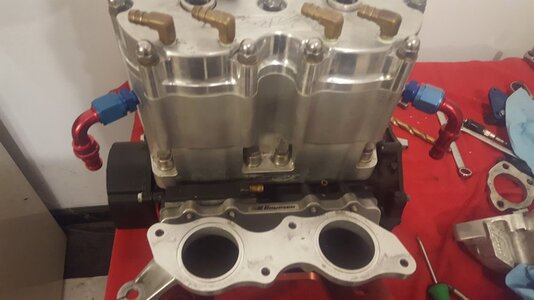

Octane_114
LeT tHe gOOd tImEs RoLL
Charleston S.C.
My dual cooling, running in the higher rpm's cylinders tend to run hot. You can see my spacer, off to the right in the picture.

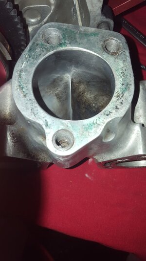

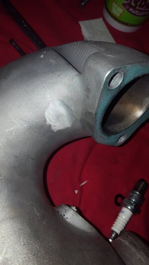

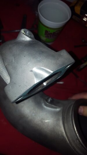

Octane_114
Charleston S.C.
Only two place on the head pipe that got touched. I have full lift out of each valve.
