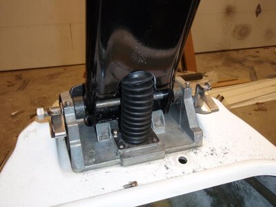

Thats all there is to it ,now turf that nose .I got pump and trim done started on the pole didn't like the cable adapter so i used a 750 cable its shorter on turn plate end worked great.Had to mod the cable end a little and the bottom off the pole to use a spring .
