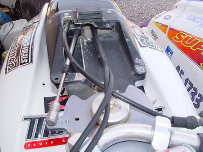

BTW: to give an answer, AC is the only one that bolts right up.
The replacement AC pole for the kawasaki.
Actually the UMI or the RRP will bolt right up with the proper bushings. They have been designed to run the SXR cable on the left side.
The AC or oem superjet pole (yamaha based) will need to be opened up to clear the steering cable.
You will need to change out your steering plate and chinpad unless you use the ac replacement pole.
OEM
OEM
OK, maybe I should clarify what I meant. AC Kawi pole you wont have to adapt the steering like you would with a UMI.
