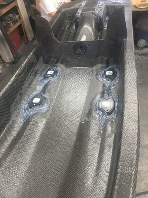

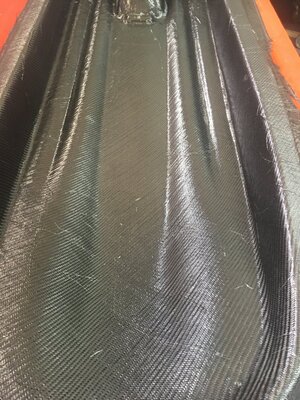

Here area couple of pics as I recieved the hull parts. If there is any doubt in quality? This will disprove it! For a custom, built to order shop. Toby has done his homework and then some!
All the hull inserts and motor mount beds are custom cnc to his spec.
