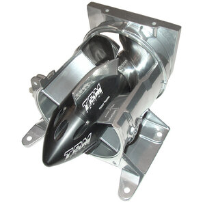

TBM Pump Cone
Has anyone used or heard the results of the TBM pump cone.

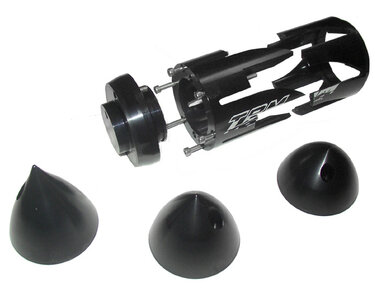

I just ordered 1 today for my SJ.I hope it is worth the money.295.00 not bad price.It comes with 3 cones.
I will prob be using the short freestyle cone
but lets see if it is comp to a Magnum.
I ran a Magnum in my sxi years ago for freestyle and the diff was awsome.
It was just to heavy....The pump and the ski ...LOL
I am just looking for some feed back if anyone has any thanks

I have been running the TBM cone for a few weeks now, that thing ROCKS :woot: It mo def hooks up better than stock, don't know how much better a Magnum is but :bigeyes: the TBM is worth $300 IMO! I did drop down to a smaller pitch, I was using a 13/17 concord, now I'm using a 13/15. For what it's worth, it made my backflip attempts sooooo much closer to coming around :biggthumpup:
I have one on my SXR and very happy with the results. It really keeps the pump hooked up in the rough. Tim has reccomended pitches for the SXR from stock to full race. Not sure how much testing he has done with the SJ. Give him a call, he might even have a used prop that he can sell you. He really helped me with my set up.
