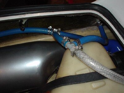

Tap into a line of surgical tubing running up your arm and fill your suit with warm water. Tap into your helmet as-needed. Just gotta maintain comfortable running temps and don't go wot :angryfire:
did this last season, works great.......
thought about a line into the wetsuit, but seeing as jellyfish DO get sucked up into the pump on occaision................................................
(and yes, the T has since been fixed....)

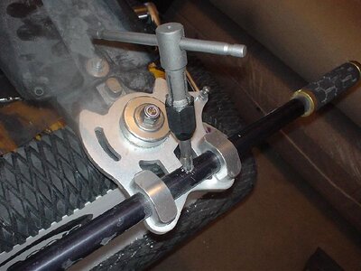

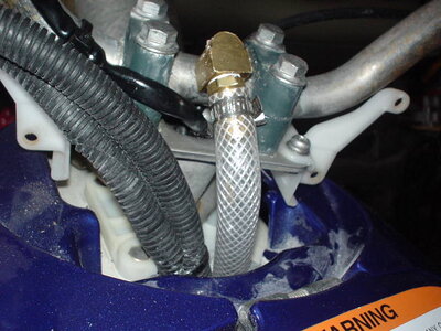

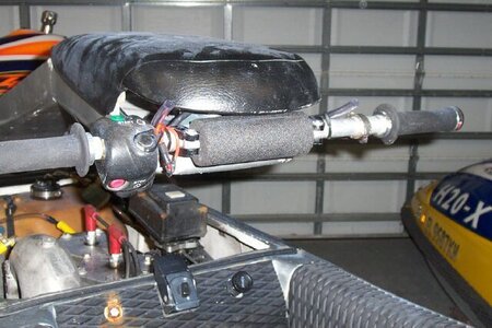

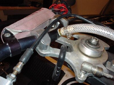

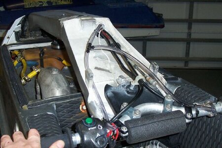

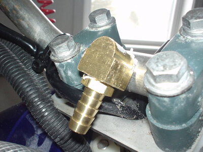

I've done this and my boy legdrag has it too .We ride in the winter here in Massachusetts and it gets pretty cold .
We run a line from the pissers to the handlebars and drill holes for each finger .If you want to get fancy you can put a valve in to adjust the flow too .
The whole hose spraying on your hands doesn't work .Been there done that :rolleyes: it has to pressurize your bars to work effectively .the guys saying the hose spraying on your hands worked great have never had their bars pressurized and dont know the difference .the wind and conditions make the spary go everywhere but your hands .
I call that the getto handwarmers :haha:
Honestly it takes less time to do this mod than any other I've done and less time than running hose to your hands to spray on them
Here's a couple pics and believe it or not I got this idea from Skidaddy who lives in Florida .LOL :haha: :haha: :haha: :haha: :haha:

looking at this though, if thats a 1/8" hole, whats the diameter of your bars 3/8"
attachment.php
and I mean really, do you think having that hole there makes them STRONGER?
ask an engineer here to do some calculations on the strenghth of that tube, with and without the hole, and I think that you will find, despite whaty you think, that it is weaker now.
How much weaker?
I dont know, im not an engineer, but I KNOW it is in fact weaker WITH the hole.
