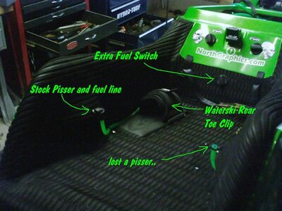

footwarmers... I ran a 2nd fuel reserve switch to my ski to turn em on and off.
Either the water goes out the regular spitter or on my feet while they are in the footholds.
ps... they work great. Even at high speeds.

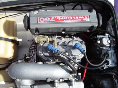

Bringing this back to ask a question. If I "T" the black hose coming from the head to the exhaust will that work or is that not going to cool the exhaust enough?

Geek uses the 'ghetto' version up here in warm Michigan. It works fine.

My hose is only 7/16" so the hole isnt gonna be nearly as big as the 'surgical' hose everyone else is using. I just want to know if that hose is going to work :dunno:
