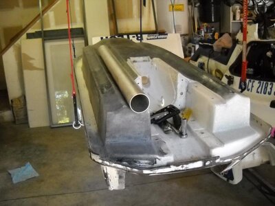

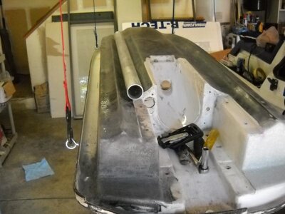

got some new good's for the ski the other day 2 1/2" aluminum tube to go thru the tray and a piece of 2" off water box to the 2 1/2"

its nice when i need to work on top or bottom other wise i have to drag it around flip over and do this and that this way i got tie downs
