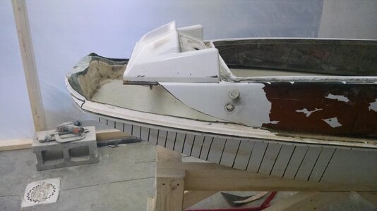

With the tray cut out and summer just around the corner, I made the stupid decision to go ahead and "just quickly" do a shorten and rocker...
I marked out the shorten and cut about 4 in off the back, including the back edge the has the stern eye in it. Looking back now, I wish I had not cut off the that back edge...
I used a string in attempt to keep everything symmetrical... it worked alright

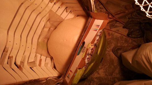

I wanted to use 2 part foam to shape the nose and to lay the glass and carbon on.
To prep for the foam, I laid some plastic on the inside of the hull and made a beer box structure for the foam to form to.
I then hung the hull from the ceiling and poured the foam in
I tried to use my hands to hold some of the overflowing foam in... turns out it gets quite hot... you can see where I had to pull my hands out of the gloves. ^
