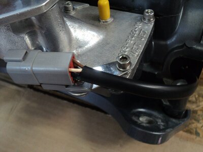

And of course wasn't happy with first bracket( it could rock "up" loosening bolt), so do over.
The little dogleg fixed that.

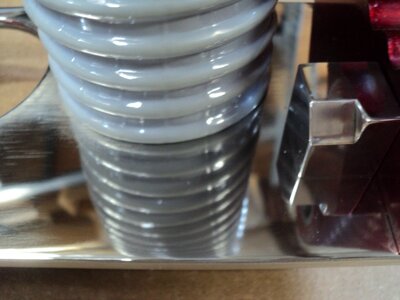

Since I wasn't running bilge pumps I came up with these to plug the holes, leaving pump optional for future. Never throw anything away, these are hole-saw drops I had.
Had spigots on pole plate and they worked pretty good up until I added a pole spring. So delete. As I was deleting I came up with leaving holes tight and nosing over inside edges, allowing breathers to "snap or lock " into plate.

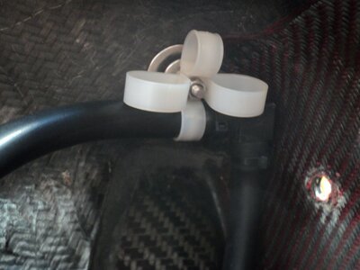

Previous owner must of tried the exhaust off a 96 F150. Someone was proud of this.
I could not do this myself. I am a coward. To cut up beautiful carbon like this....
Looks awesome man! When I had that box in my ski it was one of the most quiet skis around. But it was kind of wild on that hull the inside of it was completely turfed so I am sure that’s what addded to the quietness.
Your stator is in the pump on this also. Old parts never die, they just go into another ski!
