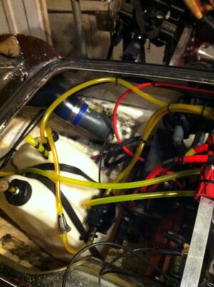

The tygon does change color. Mine is still soft after a season. I have used it upto two seasons and was not hard or breaking down but it was dirty looking. I don't know how long it would last because I change it every couple seasons but its safe to say not as long as oem. That stuff lasts 20 years. I use tygon because I can see my fuel flow. Not that it's that important ImageUploadedByTapatalk1351986450.921820.jpg
The tygon does change color. Mine is still soft after a season. I have used it upto two seasons and was not hard or breaking down but it was dirty looking. I don't know how long it would last because I change it every couple seasons but its safe to say not as long as oem. That stuff lasts 20 years. I use tygon because I can see my fuel flow. Not that it's that important View attachment 201078
Tricky did notice once on my ski where I was sucking air at a fuel fitting. That the good part about these type lines. Otherwise I might have never known. But had I had OEM line. There would not have been an air leak!

FWIW Ive been using Tygon in my B1 for the past 3 seasons. Entire time its been using E10 fuel and left in the cold during winters. Still soft and I dont have to use zip ties. It has gotten a fog to its color though.
I have old oem fuel line from like a 95 SN that had finally split. It takes along time for oem stuff to break down. It's by far the best stuff going, I mean Yamaha uses it right. I can get tygon just down the road at home hardware. It's never let me down. I have used it on mini bikes lawn mowers and even temporarily on my vw fuel injection. My kubota diesel has some on it and its fine. I think my 1969 Honda mini trail has some on it for close to 10 years but it gets little use. In the winter when I am overhauling things on the ski, fuel line gets done needed or not. The old clear stuff would go from soft flexible rubber to rigid solid breakable line in less than a month. My kart tank came with some and it's junk line. With clear line I can pop the hood and see if I have a fuel problem or ignition problem if I drop a cylinder. That hasn't happened in a while but it is kinda nice. I am not against oem fuel line at all. If I could get it local I would use it.
