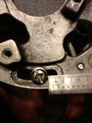

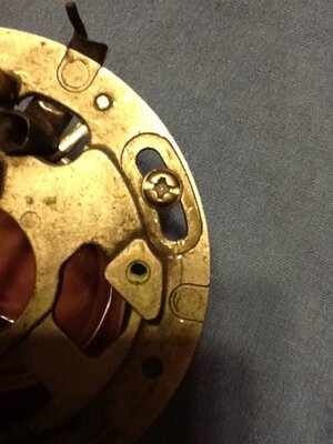

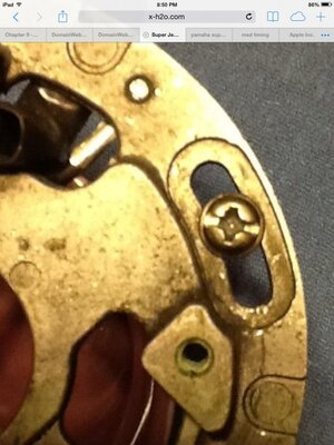

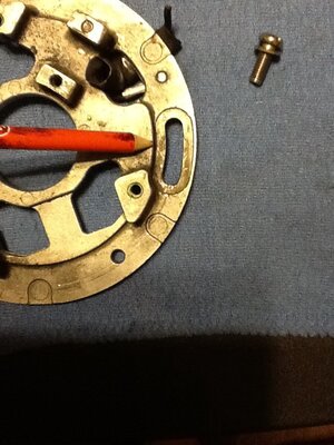

I bought one off ebay, cheap new aftermarket and found the same thing "no chiseled timing mark". Decided I would lay the new one over the old one back to back or on top one one another and transfer the mark. When attempted this I found the new mark, it's not a chiseled mark but a laser etched faint line, it's there just hard to see and looks different. I did re-chisel the etched line once I found it so it's more user friendly
For other situations I've don't this measurement of the old stator to set the new one, came up with 6mm

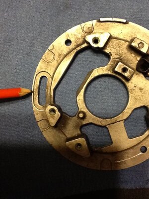

Since the stator mounting plate cap screws are not centered in their respective adjustment slots when at TDC I wondered how many degrees of timing advance this would creat. I measured 2mm's of counter clock wise movement so I'll call it "+2 degrees of advance plus".
