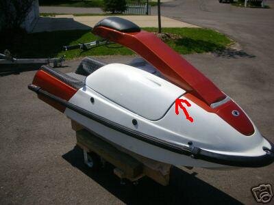

The hole I'm talking about is looking from the front of the ski, on the left side at the front under the hood. The thing is huge and every time I do a sub my ski gains about 20lbs, haha.

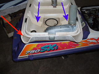

On a SXI the front and the rear of the hood are seperate air wise. So if you block the front air intake off from the inside there won't be any water get in through the front. Then you can open the other side on the rear so you can still get enough air for the motor. The only way water enters the ski is when the rear of the hood is under water.
Here is an old picture of where I cut my 2nd hole. The red line is where the 2nd hols is and the blue lines are where the hood is sealed so that the front and rear air intakes are seperate.
