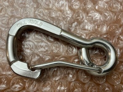

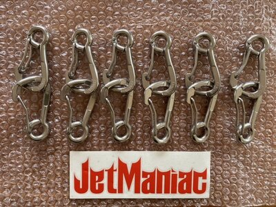

Attachments. I tried soft shackles only, tieing knots on demand, and tow hooks, and tow hooks have it for a couple reasons: speed and ease of use while wearing gloves. It also makes putting it on your body easy, and you can unhook it with one hand, if forced to. I looked at a variety of hooks and carabiners, and the Suncor clips sold by JetManiac really look the best. Wire gate is critical to keep sand from fouling the mechanism, no sharp edges is critical for not snagging rope, stainless steel is stronger than aluminum... Note that there are different makers and models, but this particular option is great. There are cheaper alternatives on AMZN, but they aren’t as strong, so I didn’t bother with them.

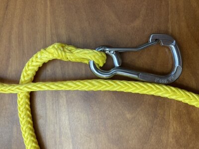

To put the clips in the end of the rope, I use eye splices to retain the most strength, and the best knot site on the web can show you how better than I can:

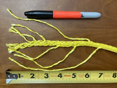

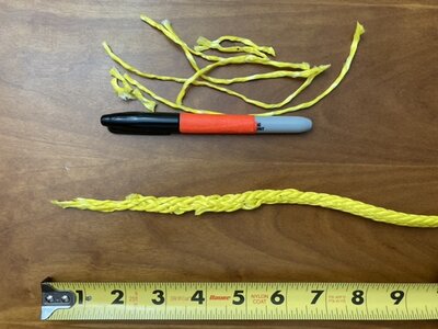

Burying enough of the end is key to the strength, and tapering it helps save the rope from an abrupt transition... here’s my taper.

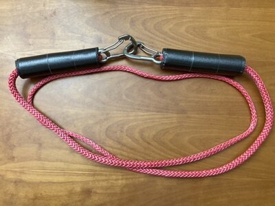

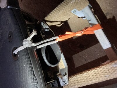

So there’s a finished product! I use soft shackles on skis without tow hooks to create an attachment point.
Brummel Splice Demo
The intended strength is derived from the long tail being tapered and buried through the center of the standing end; which exerts a powerful gripping action under tension.
www.animatedknots.com
