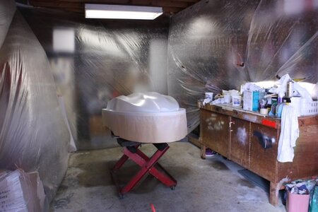

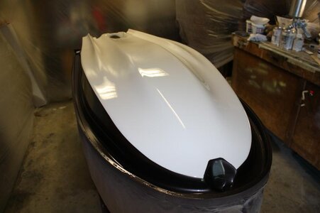

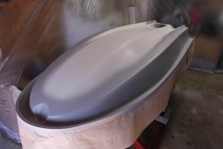

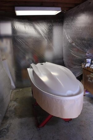

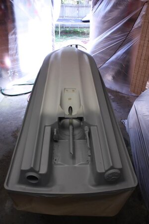

I am painting Rizk's X2 for him.... It will be champagne pearl w/ a charcoal/white bottom using Chroma Base and Chroma Clear w/ pearl in the clear coat to give it some flipity flop.... I have the bottom already painted white and getting ready to do the charcoal on the bottom sides.
I'm gonna finish the bottom first so I don't have to flip it again. I'll just clear it today after the color and flip it tomorrow after the clear is dry...

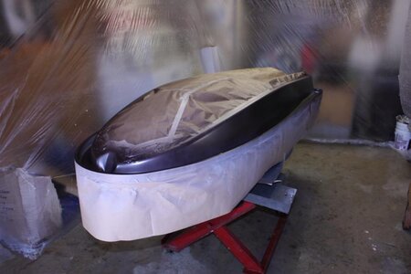

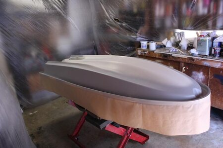

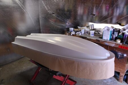

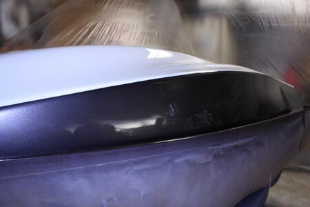

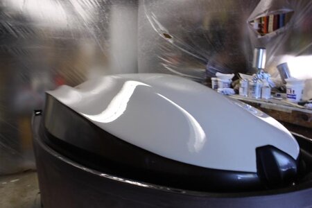

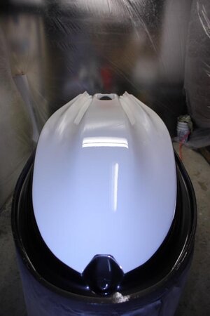

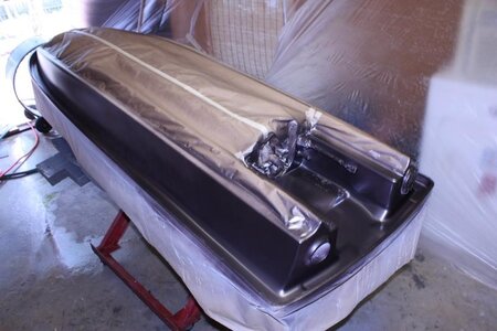

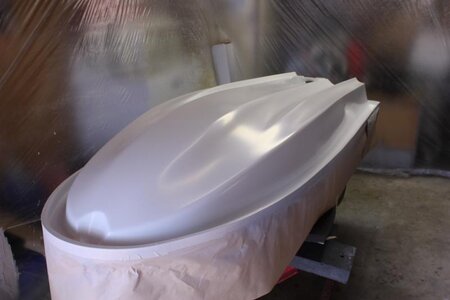

next step:
  • painted bottom bright white
  • waited 45 min
  • taped off the bottom and sprayed the sides charcoal metallic...

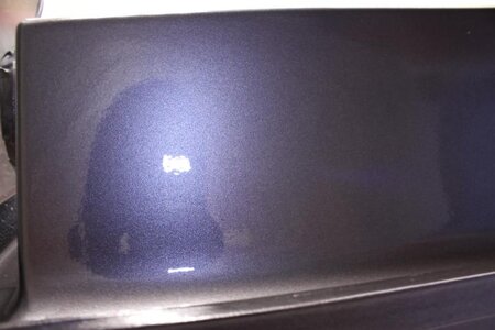

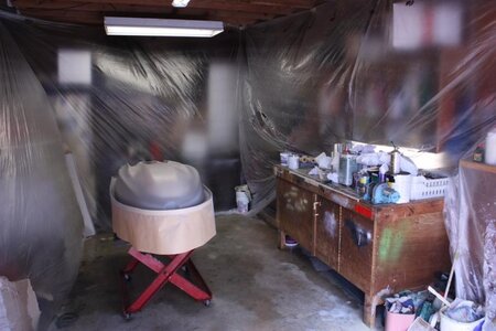

yeah... I recommend DuPont Chroma Systems to anyone... it really goes on smooth and the colors are real vibrant. All the paint, primer and everything to do about 2 skis costs about $700.00 which is not bad.
mind you that is not paying the painter.... he he he..
