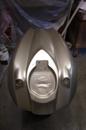

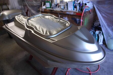

Custom/Hybrid Trinity Composites X2 / Paint Process

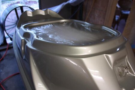

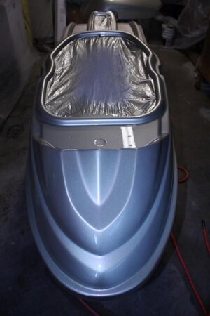

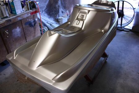

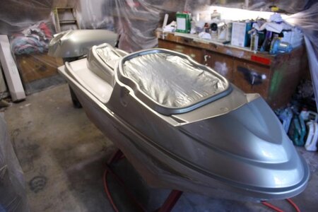

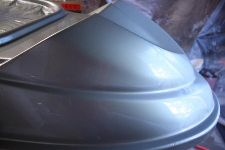

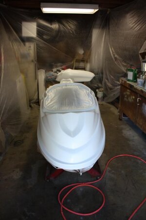

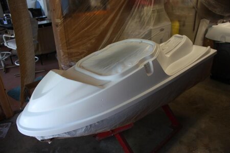

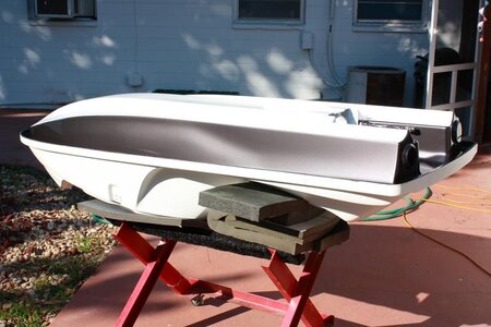

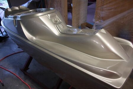

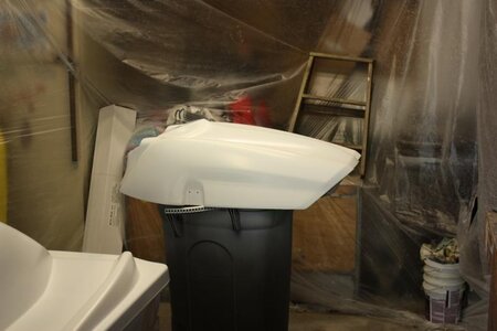

  • white sealer as a good solid background for the basecoat. You don't want to paint a light colored metallic basecoat over anything but white if you want the color to show properly...

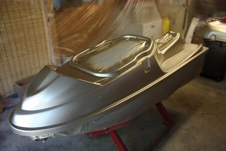

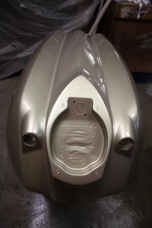

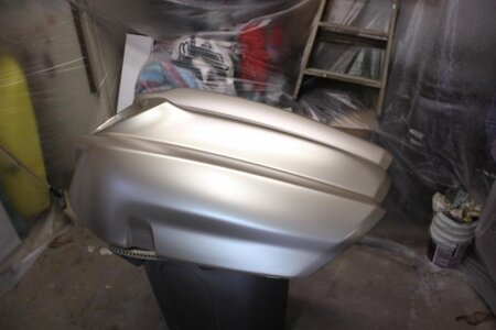

  • then I painted the color which is "Champagne Fizz" OMG... this color is amazing!!!

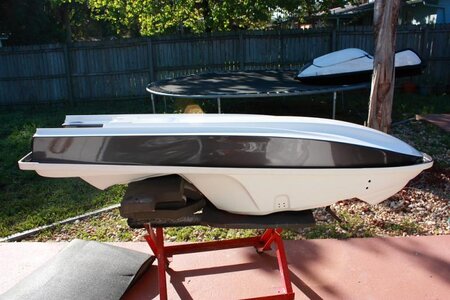

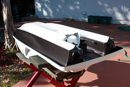

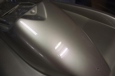

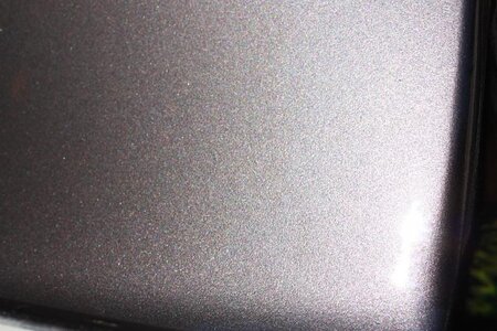

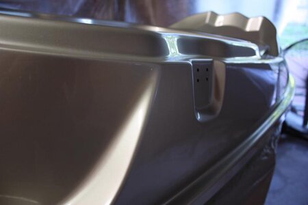

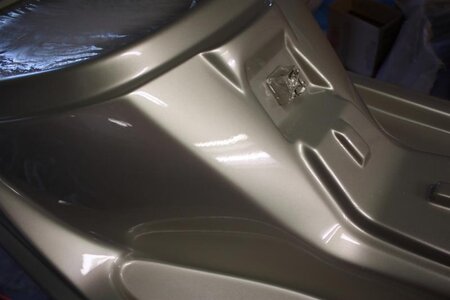

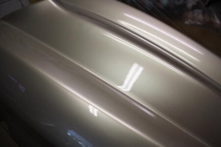

  • After that mix 2 TBS of Green pearl into 1 quart of clear and lay 2 good coats on the ski
  • when that is tacky spray one more heavy coat of clear w/o the pearl in it to protect the pearl...
walla, you have a paintjob...
clear pics to come after it is less toxic in the booth...

fyi- this boat did not even need a primer coat it was so freaking tight.... I want to commend Bobby's work again... the attention to detail on this boat was ridiculous!!!!
clear pics next!!!!!
