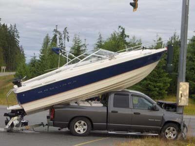

Other (Truck) Ski launch system with boat attached
Twinturbostang I did not know you could do the trailer tow with your unit.
Many customers do. We don't sell it that way because most vehicles can't take the weight.
You won't find a stronger hauler on the market, it would rip the hitch off your car before anything happened to our hauler.

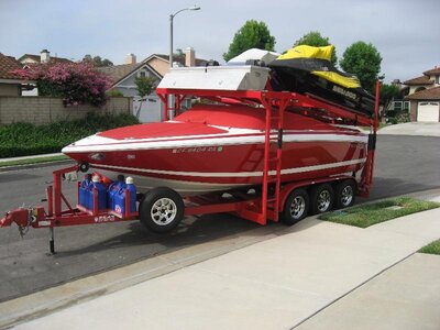

I built this exact system and could launch easily with the boat trailer attached (Just angle it down the ram a little after launching the boat.
http://www.youtube.com/watch?v=S6AQdWzzoKU
My (old) rig:
Worked great, and no modifications to the trailer needed!
-Rob

Hey, that top one is me!
I towed my boat and ski alot with that setup. But you had to take the trailer off, once the boat is off, drove away, dumped the trailer off, dimpled the ski and it was good!
