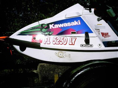

side
Man that is a bummer. Maybe I will run it out the side 3/4 down to the rear or where my scupper is. Seems like scuppers are more trouble than they are worth. Sometimes they are awsome but other days they just piss me off, especially in surf.
thats how i have mine. right behind the tubbie
