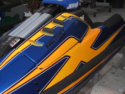

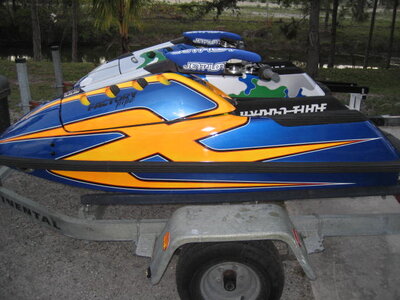

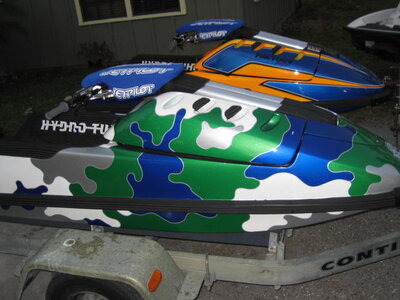

just finished two more builds and there going to the water for there first ride .

bross nailed it . these are 785 flat tops with a single riva intake and novi 44/48 carb . the head is 2007 version ada racing . this motor has proven to be as reliable as a stock 701 mazing the amount of hours i get out these. thanx guys i will post pics of my latest paint job next ski in the worx .the camo is a wammer hull and the other is stock reinforced . wammer hoods . and one has billet rrp handle pole .

i would paint the cylinder but the customer does not care so ,the bronze is the result of the silver cylinder from the baking in the oven for dropping the sleeves . you will see in a couple months i have an all out project planned .

I like the design on the Yellow/blue one... very simple and fits the ski well
