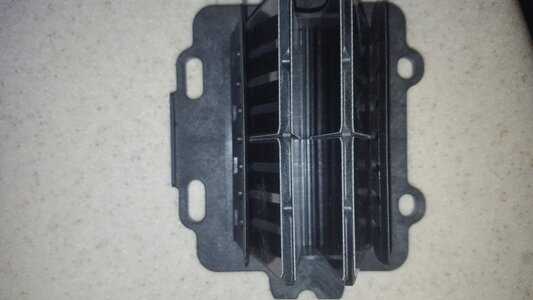

Still think Reed spacer would be a good idea? I thought the thicker flange of the vf3s was supposed to act as a spacer.
Jr.
Standing Tall
Hot-Lanta
Your looking at the spacing wrong. The manifold needs to be spaced back pulling the reed blocks with it.
The thicker flange moves the reed tips closer to the crank.
Thats easy, Boysene Pro Reeds. Direct bolt on 62t oem cages Very strong and withstand frequent water injestions,
Very good consistant performance, with minimal fade over time.
Another option that I have been doing for years is fitting Kawasaki 750 cages to work on 62t manifolds
Run same Boysene pro reeds (K750 fitment) these have slightly larger cage area, allowing more flow than Yam, and a better angle of attack into case. Can be modified easily with a dremmel tool.
I think I have a set in a box someplace? Let me see if I can find them and post pics?
thanks for solving my mystery!
my XS engine has a kaw reeds and cages...couldnt figure out what my spare set of T reeds was different
thanks Paul!
