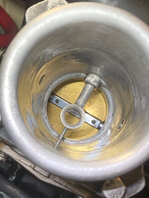

Last time I rode my ski i noticed smoke emitting from the carbs after i shut it down. Also, if i pushed it into the water to force water up the exhaust tube, smoke would billow out AND i could hear the reed pedals humming a tune. So, i pulled the reeds (some kind of old dual stage reeds) and sure enough a couple pedals were opened up. So, i just replaced them with new VF3 reeds and put a Wax intake manifold while i was at it.
NEW PROBLEM: Ski will not idle on the stand unless i open it way up to probably past the low speed jet orifice. When running, it is spitting fuel up into the air in the form of droplets. I will say it sounds extremely snappy compared to the last time i revved it on the stand (old worn reeds?). But i am puzzled by the spitting fuel.
THEORY: Could this be that my low jets are incorrect? Could the worn reeds have been tricking me into improperly jetting my ski? I meticulously tune my skis, changing one jet at a time etc etc... I never ran this ski with new reeds before, as the first time i ever ran this motor was this season with those old reeds.
Any words? Posted is an image of the droplets resting on the blade. Thanks!

alrighty so i did confirm tonight that there is fuel dripping from the venturi. I raised my popoff to 21psi which is the highest i can see being practical in my application. No point in raising it to see if it fixes the problem if i can't go much higher than that when i start to re-tune the ski.
So.. this means drilling the restrictor and putting a restrictor in the return lines. Gosh i really hate the fact that that is necessary tho. I am trying to build a high RPM ski and i worry about fuel pressure at higher revvs. Also, it's just one more thing to tune and consider for diagnosing. There must be another way to stop the dribbling fuel from the mains?
I checked for a clogged return line. It's clear. I really should replace my needle to see if that's the issue. Sometimes when i do a popof test i get a hiss instead of a good pop. So that may be an inticator. I will also try a stronger spring with a larger N/S and aim for a similar popoff. Maybe the anti-siphon valve too?

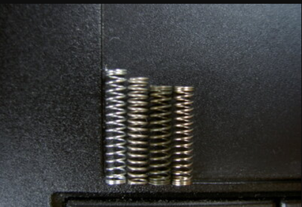

I would keep your 2.3's, make sure they are not shot and maybe even 2.0's if your into tuning. (that's me) I own multiple 60+ MPH standups and none of them require 2.5's even with 46 Mik's or Novi 50mm Carbs. Only time I ever "needed" 2.5 was racing with MS109 fuel or in my race only GP1200R. Get yourself a set of 115, 95, and 80 springs (cheap)

You got to go with 1.8's! The springs are different if you really look at them. But you need to check with a gauge. Even buying two of the same springs may give different results.
@MTRHEAD When you test pop off on dual carbs, do they both pop at the same time, or is within 3-5psi good enough?
115 gram = gold spring
95 gram = dull silver spring
80 gram = black spring
65 gram = shiny silver spring
