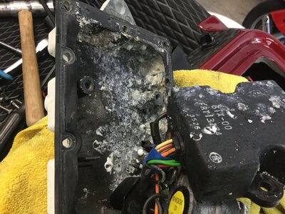

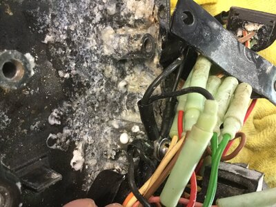

Water in electric box
What can I do to seal the electric box from getting water other than a new gasket

New gasket, tighten the screws evenly and not overly tight. I also put a layer of silicone around the seam and wires. then i spray it down with never wet. Flex seal would probably work too.
Roseand
Ready to RIP
Wisconsin
Another easier to clean up method is using dielectric grease on the seal and all grommets/wires/fuse cap.
Also, tighten the screws evenly and don't overtighten to the point the seal squeezes out. Don't need super tight as the top ebox cover has a narrow extrusion all the way around designed to dig into the gasket to seal. New OEM seal all the way!
That neverwet looks good worth a shot
And I just purchased a nano protection for all electric parts but I got to keep that salt out it was still wet from a few weeks ago don’t know if that was from the lake and the salt deposits were residue from a month ago but that’s got to stop
