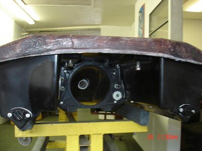

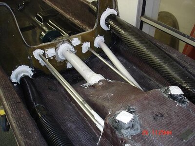

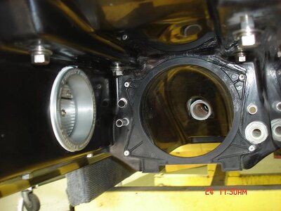

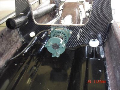

took a while to post this build thread because of a the time line that was provided to me. Here it is in the beginning process as I am trying to finish the hull to get to paint before the end of the month.
Features:
Hull - WCF fiberglass +carbon/kevlar re-inforcemments featuring the 08 SJ bottom . We will also feature a new bladder system which will have drain plugs in the back.
Full RRP pole and steering set up
Complete Dasa 1000cc billet engine
MSD total loss
full spec 49m carbs and boyesend intake+rad valves
b-pipe+ OEm waterbox (customer requested this set up because of strict noise ordinance laws otherwise it would of got a Power Factor)
148 billet mag pump
-OEM gas tank
- thrust innovation trim + new scupper drain system​

thanks guys! this thing will be one of sweetest build ever!! We are going with a copper color paint
IKSTEJ
BOGIE
Region 7
Nice work Steve
Standard WF upper deck?
Man, I love the hot rods and you build nice ones
Should be another buildoff winner :)
BTW Those Thrust scuppers look bitchin
can't wait to see the finished product

thanks Pat! coming from you...it means a whole lot!:woot:
the top deck is our new design that features the wider tray,wider engine bay ,raised hood seal and the added body lines.
Its kinda funny how the "build off" got me into building these fancy machines

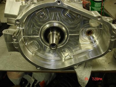

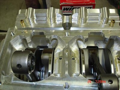

motor pics
took a few pics while assembling the engine .

WOW, nice cases!!!! are those billet?
can you explain the bladder system.. sounds interesting
well, I'm going to foam and glass the gunwale areas of the top deck and leave the bottom deck without foam but very well sealed thus keeping an air pocket present . If water does find its way in, then it will come out thru the rear drain plugs .
This is an idea I got from these boards. it's amazing what you can still learn here!:rolleyes:
ha ha... so funny, I actually did the same thing to one of your top decks for a guy here in Orlando.. capped them before we glued it together.. worked out really good

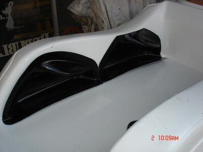

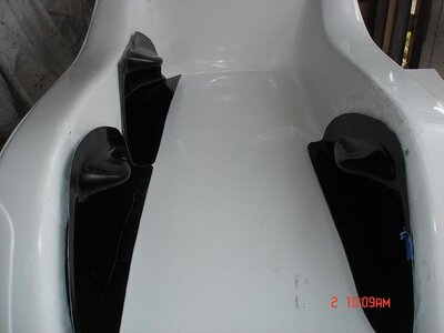

double footholds!!
Now here's a first...were going to install double footholds on the left side area. I think this is going to make riding surf style so much better!!:Banane01:

WOW really interesting with the double footholds. why not just a big front foot hold?
