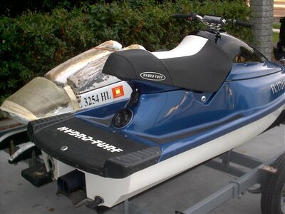

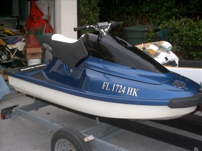

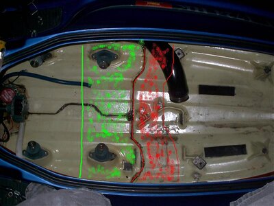

I'm also considering doing what Bonzia Bob did and actually heating up the SMC plates and moving them forward. Would this even be possibly being that the entire inside of the hull is SMC? If you look at the picture you'll see that the back SMC plates would actually have to rest on the front ones if I were to move them forward.:dunno:
you'd have cut the front half of the engine pods and remove them, they need to go forward 2 inch, the back motor mount stay where they are. no need to deal with a differnt short shaft. The pod where the waterbox rests will need to be trimmed so that you can more your other forward. I'd reglue them with some good glue and then lay some glass over everything to tie it together and make it stronger where there are open areas. Take the wd pipe, i was able to order mine in pieces so i could have it welded to clear my sj tank. Lay it out almost straight and maybe put a waterbox in the nose and then oem exhaust tube out the back
it would be easier if the front mounts were on the same smc plate but they're not. you'd have to cut that plate.
Cool. After you pm'd me and while you were typing this I went ahead and drew up something in paint to show what everyone what you were talking about.
You're saying that you would cut the red shaded portion out then pull the green portion up and move it forward. After glueing it back down you would then reinforce the whole area.
So it sounds like it's a catch 22.
If you go with the Waterdawg Mounting kit and save the time/work of having to relocate mounts then the pipe won't fit and if you decide to move the mounts yourself then you end up having to take on all of that extra work and still don't know for sure if the pipe will fit.
Trust me I'd love to turn this into a huge build project and do it myself the right and cheaper way, but time is something I don't have. I was really hoping it would all just bolt in like Jeff said.
Maybe Jeff can do a quick mock up of his mounting kit and manifold in a blaster hull and take pictures for all of us to see. If it fits like he say's it will then I'll order a conversion kit that day.
Well Jeff just pm'd me and assured me that the 66e will fit in the blaster using his kit and the pipe/manifold will clear the hull and gas tank.
As soon as I see pictures of the setup mocked up in a blaster hull then I'll be ordering the kit that day. So if anyone near Jeff has an empty blaster hull PLEASE drop that thing off to Jeff so he can borrow it to mock up this setup and ensure I won't have to modify the hull at all or have to run an aftermarket gas tank.
you really dont have to cut out the old front mounts , leave them place and mould new front ones like was done on mine and add some glass fabric over the new moulded pedistals , I already did all the homework on that one . you wont have to put as much glass on as i did mine was a little overkill on the glass dept ! my mounts are still rock solid ! FWIW
