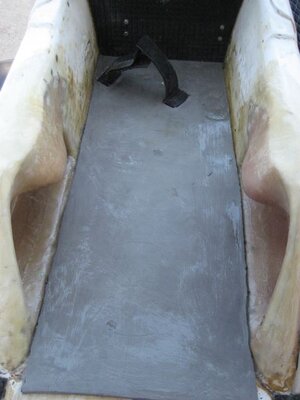

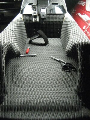

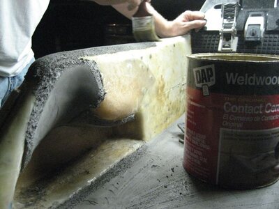

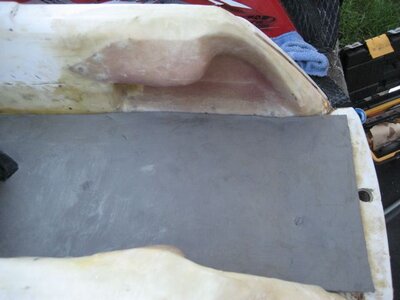

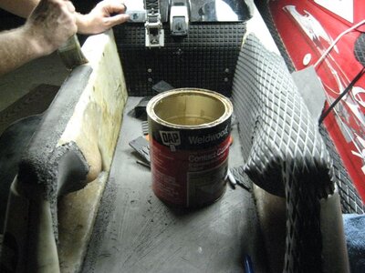

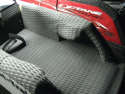

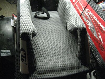

Never again. I think that was B/S. I dont like the Waterdawg holds. After spending 4 days installing them I don't even like them. My foot does not even fit in them. They have a bigger than normal hump in them where the top of your foot is, and I can't fit in there. I'm not happy at all with this project. The Rickers were so much easier to install and turf. Oh well I guess they have to do for now.

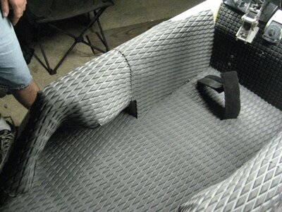

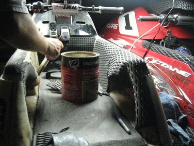

Finished 1am Day 4

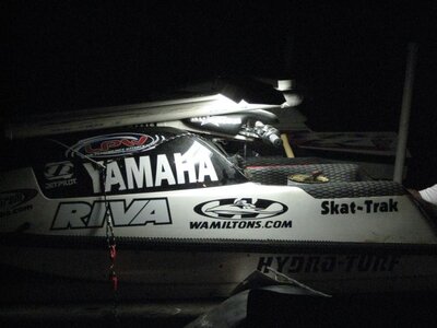

Thanks Jackie. Next week lets put in the trim system.

How do I do that when my foot won't even fit under the hump on the foothold?
do the shoes you wear have thick soles? I wears size 13s and have super wide feet and have no problem getting my feet in, even with lowtop air force 1s on(just what I was wearing when the install was finished). Need to get some wrestling shoes and will have even more room.
I know my feet barely squeeze in there in wrestling shoes, 1/2" pad and turf on the bottom an turf only on the top.
That said, I have really tall arches. The only hold I've tried that I found comfortable have been Klowners.
