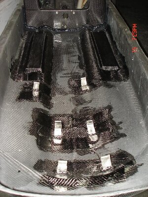

some movement on the build. Should have the top deck and hood ready for next week.
I also plan to clear the inside once completed for eye candy:love:DSC01582.JPG
Well, here it is finally, our first carbon Vision 3G. We took a long time experimenting and perfecting the infusion technique with the help of 3G composites inc. here in S FL. This hull is resin infused using 19.7oz carbon and some "special" infusion resin.
Once finished, we will add decals and spray some UV clear for the perfect carbon look:cool:
stay turned!View attachment 195741View attachment 195742
Hallo, we use for our infusion this PU-clearcoat. You can spray it with 1.7mm hvlp-gun and can work with your resin weeks after on it with no grindwork!!
http://www.hp-textiles.com/shop/product_info.php?info=p771_1500g-in-mould-coating---hp-imc-.html&XTCsid=37cda8e081cfd51b05874d099ab1e4e8
We make our moulds from highglosspainted plugs with canubawaxed survace and canubawaxing the moulds. No PVA needed and you have a highgloss and 100% UV protected Carbonpart out of mould with work after demoulding;-)))
You save time and money with this
The new carbon vision should be rockin. 3G builds carbon parts to automobile standards. I've seen their work in the auto industry, then I saw the Vision carbon bottom and its the strongest I've ever seen in a ski. Some carbon skis seem a bit on the "thin" side.
