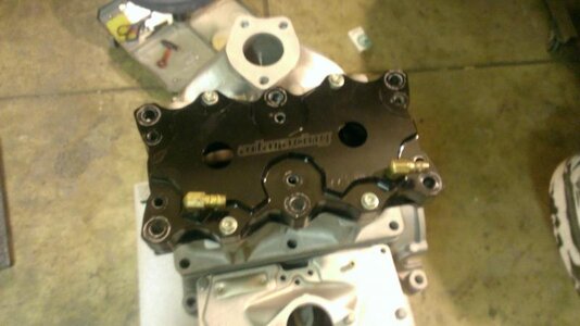

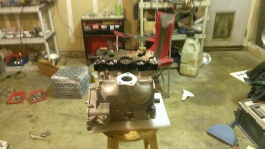

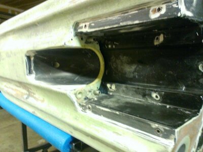

So tonight i started building the engine for the ski and as of know i have the SBT tru & welded crank in the 61x cases. tomorrow i plan on puttting the jet maniac 83mm ported cylinder on and all the other goodies. pics soon to come

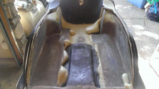

But urs was a bottom deck from an sj? Because what IV heard is the rev bottom deck is 2" wider so that plus tubbies might smoothin thing out better I hope lol

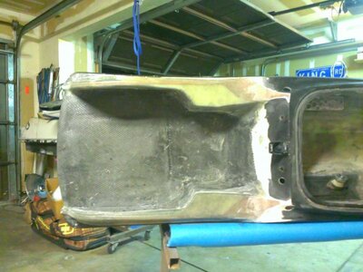

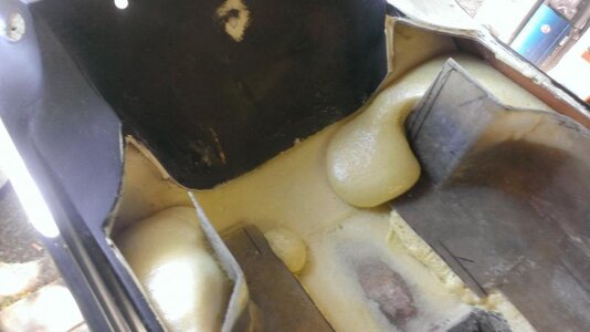

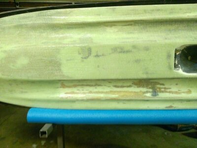

WP_20130409_001.jpgWP_20130409_002.jpgWP_20130506_004.jpgWP_20130506_005.jpgWP_20130506_009.jpgWP_20130514_007.jpg
