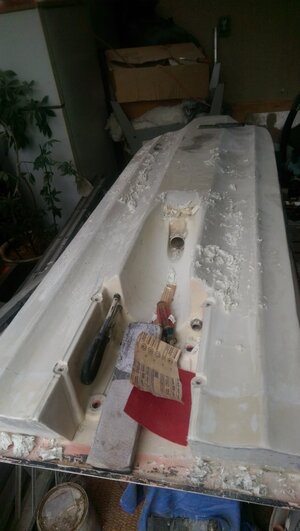

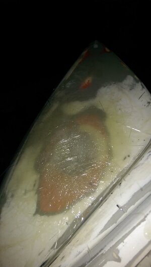

This was my first jet ski I owned ( own 3 now) when I got this baby it had a shattered piston bad crank seals and a blown crank. I put turf on it updated the motor a little at a time, and has been by far my most reliable ski. This has been a long time coming. to get a make over and update!
The plan:
- I'm converting it to a Reed with the Westcoast rc520 Cylinder
- 75.5 Wiseco Pistons
- Westcoast Dual 38 Intake Manifold
- Westcoast Velocity stacks x2
- Westcoast head( interchangeable domes ( going to use a cloth headgasket instead of metal)
- Westcoast Exhaust Manifold
- Westcoast Pipe (5 ring)
- Westcoast Bulkhead Brace
- Westcoast dual scoop hood
- Westcoast Waterbox
- Westcoast Bilge Relay
- Rule 500 GPH bilge
- Lightned Flywheel
- Welded Crank
- Westcoast OS Tank
- Westcoast Ride plate
- Westcoast Intake Grate
- 440 Pump with a 16.5 skat
- Converting from Nose exhaust to Rear.
- Westcoast Themed Paint
- Dual Cooling
- New turf (might do Jet Trim)

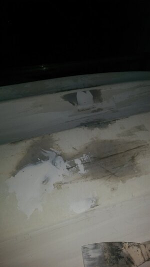

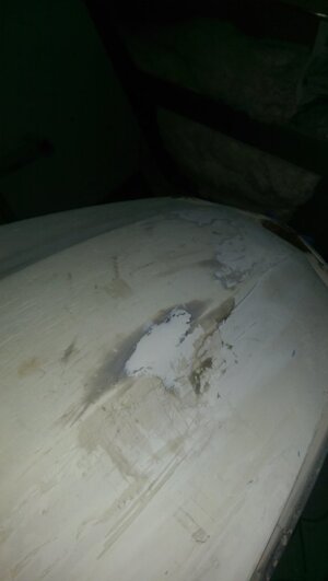

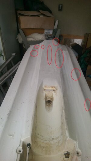

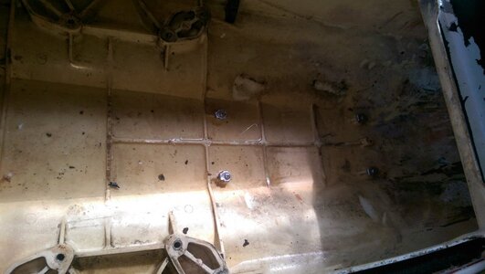

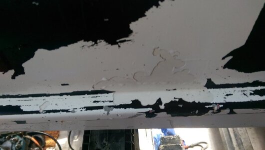

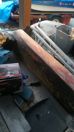

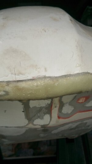

- Truing the hull as well as reparing
