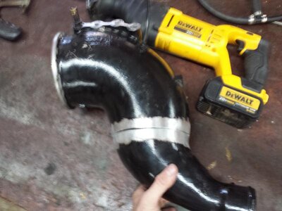

Well Finally found a place to weld my exhaust.
Ill save myself 70 bucks if I cut and clean it my self. So I will hopefully be tackeling that today.
Then I gotta find time to drive the thing 40 miles back to the city to have it welded.
TADA!!
Sorta,
Part A really. But its a start.

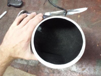

I ran into a problem that I hope the Machine shop can handle. One side of the chamber is 2x thicker then the other.
I will try an even it out. But who knows how well that will go.
I will attempt a fitting tonight to see if anything needs to be shortend, rotated, ect.

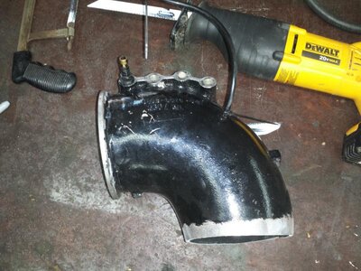

Well to revive a probably dead thread.
I got the exhaust welded and mounted. But. The angle is wrong. Its pointing to far towards the gas tank. And is pointing down to much. I should have removed about 3/4 of an inche out of the chamber and marked how I wanted it welded better.
So I don't know if I want to scrap it and save for a real pipe. or throw more money at it.
Suggestions?

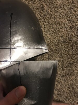

I had to take a 1 inch to nothing pie piece out to get mine to fit in the fx1
It's looking like im about to do the same... that bottom line is if my welding guy can add some of the cut material back into it. If not, im having him cut the top line off. its almost a 2inch to nothing pie cut. Any idea on how this will affect tuning?
Theoretically the slightly shorter length will bump the power up to a slightly higher rpm.
Also theoretically, it shouldn't be much of a difference, you are making less change there than the difference between a "limited" and "mod" B pipe chamber.
I'm doubtful you'll notice a difference, but I would try to keep it as long/close to original dimensions as possible, or at least as practical.
