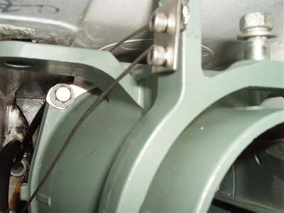

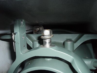

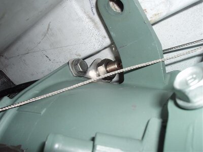

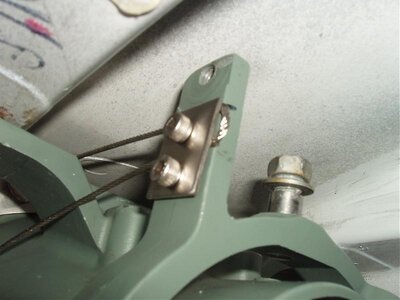

Look at Mark's first pic, you can see he used small pvc pipe.
I have a thinwall stainless tube running through for mine in the very top left corner of the pump cavity.
How are you guys running these cables through the hulls?
