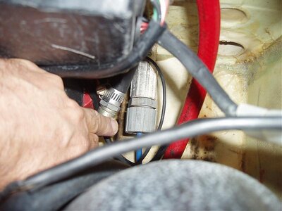

1/2" pvc pipe and in the hull a female coupling on the end of the pipe with a seal tight cord grip connector from McMaster Carr is how I did it.
Drill hole is the pump area and cut the end of the pvc pipe into a saw blade and rotate it through the foam pulling out a plug of foam. Then drill hole in the bulk head.
I did mine when I had the tray cut open.
Mark44

that helps, how did you drill the hole on both sides and have them line up perfectly? I can only see using a long drill bit or something to go through to make sure the holes line up through the foam and all.
#ZERO
Beach Bum
Florida - U.S.A.
Pro-Tec sells a 3/8" drill bit that's 35" long for $18.95 and it works perfect for the job.
If you drill a hole over top of the pump on the left side and parallel with bottom of the hull it will come out in just the right spot.
Also they sell a stainless steel cable tube and rubber sealing grommets that work good too.
