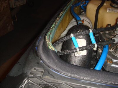

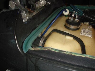

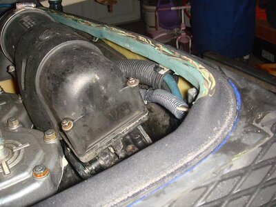

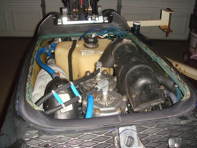

Surf= make your own from Hydro turf- be sure and make a little lip on the sides so your hood won’t slide when you start doing rolls. Check mine-
