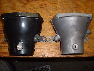

But your problem is the Protec nozzle. The protect nozzle has a ton more room inside it compared to a stock nozzle. The easiest way to explain it is when you bore a stock nozzle out to 85mm the lathe actually cuts a section about 3 inches long and when boring the protec nozzle the cut section is about an inch deep. It was like having 2 or 3 wetwolf cones installed. So the pump worked better with the longest cone because it is taking up the extra room.
Look at this picture you can see that mid way through the nozzle the diameter is a LOT bigger than the stock nozzle.
