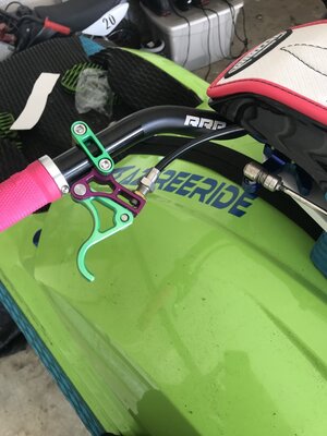

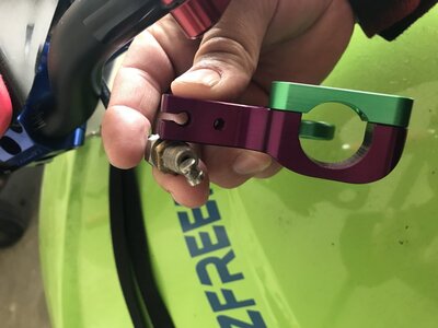

So I just ordered an FRI levers and I ordered for a Yamaha as I have a 760 in my Phantom with 44’s
Didn’t pay attention but I have a thicker throttle cable that fits a Kawasaki size throttle . What cable is this? Maniac ?9CFFA261-487F-472B-8EAF-DF9AA304BEEF.jpeg

That doesn't look like a Kawi sized throttle lever, that looks like a Yami sized cable only lever.

I think it's more cost effective to acquire a 10 mm throttle lever for your cable then to purchase a oem Yam cable for $112 street/162 retail.
He has that new bling billet throttle lever so an a/m yami size cable for $55. would be the easy solution.

Sell the throttle to someone else. Sure you have the bling but the 10mm cable is much less likely to break. Can you not return the lever if it is new?
