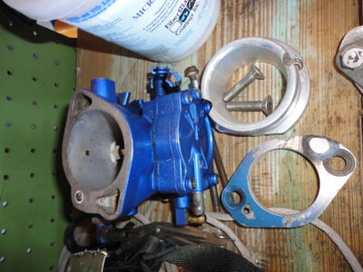

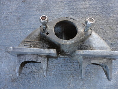

I have a 42mm Keihen and a manifold for sale. The adaptor plate was damaged. I welded it but am no longer running 650 motors, so I never sanded the adaptor back down. It will also need another long bolt, as the replacement bolt that was on it was not the right bolt and is what damaged the adaptor to begin with. You wouldn't need the adaptor plate if you had a keihen manifold, but all I have to go with it is a mikuni manifold. You would still need the replacement bolt regardless, but I have 1 so it can be matched. Carb looks good, probably doesn't need a rebuild, but it's been sitting a while so it's probably a good idea.
View attachment 175737View attachment 175738
$100 shipped for carb, adaptor, manifold and all of the hardware I have, as is condition. Can e-mail other pics.
