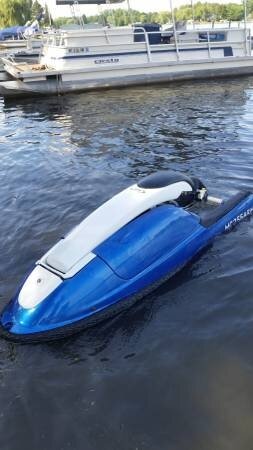

I can either get a 98
750sxi pro. pro with a custom paint job
It also has foot holes molded in and brand new hydro turf all the way after market intake grate1,600

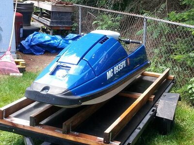

Or a 1993 Yamaha super jet (blue) with New blowsion 0 degree Bars with Odi Rouge grips. also comes with stock bars without grips.
After Market prop (unknown, was on ski when I bought)
Bilge pump
New start/stop Switch
New stx9-bs Battery
What it needs:
Choke cable (I just pulled the hood off and used my finger if ever needed)
Gas door on nose piece is missing. (most sn superjets are missing this, effects nothing)
The turf is in usable condition but could use some new turf this winter.
1,600

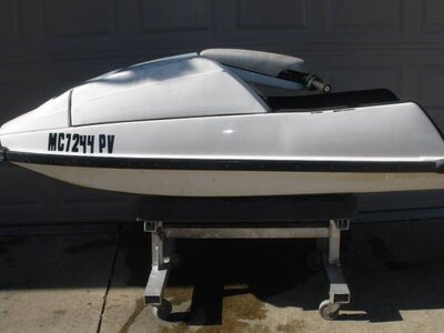

Or a 1994 superjet (white) looks like it needs some turf and in decent condition 1,200

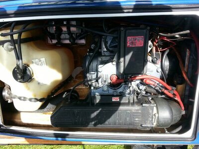

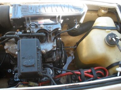

94 looks to have a pretty crusty looking motor.
93 is much cleaner.
Either one of them have a 701? the 94 should have a 701.

I'm partial to the blue one. A 650 that runs is faster than a 701 that's always broken ;) the whole white ski seems like it hasn't been taken care of at all.
Fully agree. Plus in the winter, you could disassemble the motor, clearance the cases and install a 701 top end.
