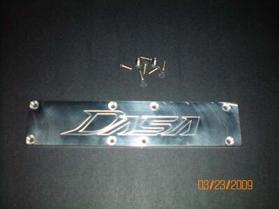

Just epoxied up my cases for my ada 989 build. Wondering about what has been refered to as " disaster plates" which are bolted to the bottom of the cases to help support the epoxy. Are supports necessary on the 2 sides? I'm making a plate for the center as the epoxy is thin. I wish someone sold these plates as it'll take me more time than I have to machine some for the sides. Can't find to much about 8mm stroker case mods.
